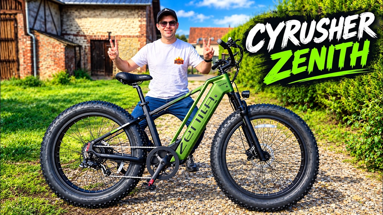

100 KG on the Cyrusher Zenith: Does it live up to its promises? - Full Review!

Main Specifications and Features
Price: About €1,299.
Motor: 250 W rated, with roughly 960–1,000 W peak and 95 Nm of torque.
Battery: 52 V, 15 Ah. The reviewer initially says 20 Ah, then corrects himself to 15 Ah.
Claimed range: 96 km, described as theoretical rather than verified in the test.
Weight: About 34 kg, considered relatively light for a fatbike of this size.
Wheels: 26 × 4-inch fat tires.
Gearing: Shimano derailleur. The reviewer considers the gearing fairly basic, noting a low pedalling cadence in first gear on steep climbs.
Brakes: Logan hydraulic brakes with dual-piston calipers and 180 mm discs, praised for strong stopping power.
Suspension: Adjustable, lockable front suspension. It handles ordinary rough ground adequately, but the front end struggles over larger bumps.
Fit and equipment: Comfortable seat with a broad adjustment range. The frame is available with or without a crossbar, and the bike comes in three colours.
Display and controls: Bright, clearly readable screen showing battery, mileage, speed and other ride information; five assistance levels.
Lighting: Front light and frame-mounted lights that brighten when braking; no light at seat level.
Sensors: The bike advertises both torque and pedal-assist sensors. The reviewer also notes that a throttle can be added for off-road or closed-road use, subject to local rules.
