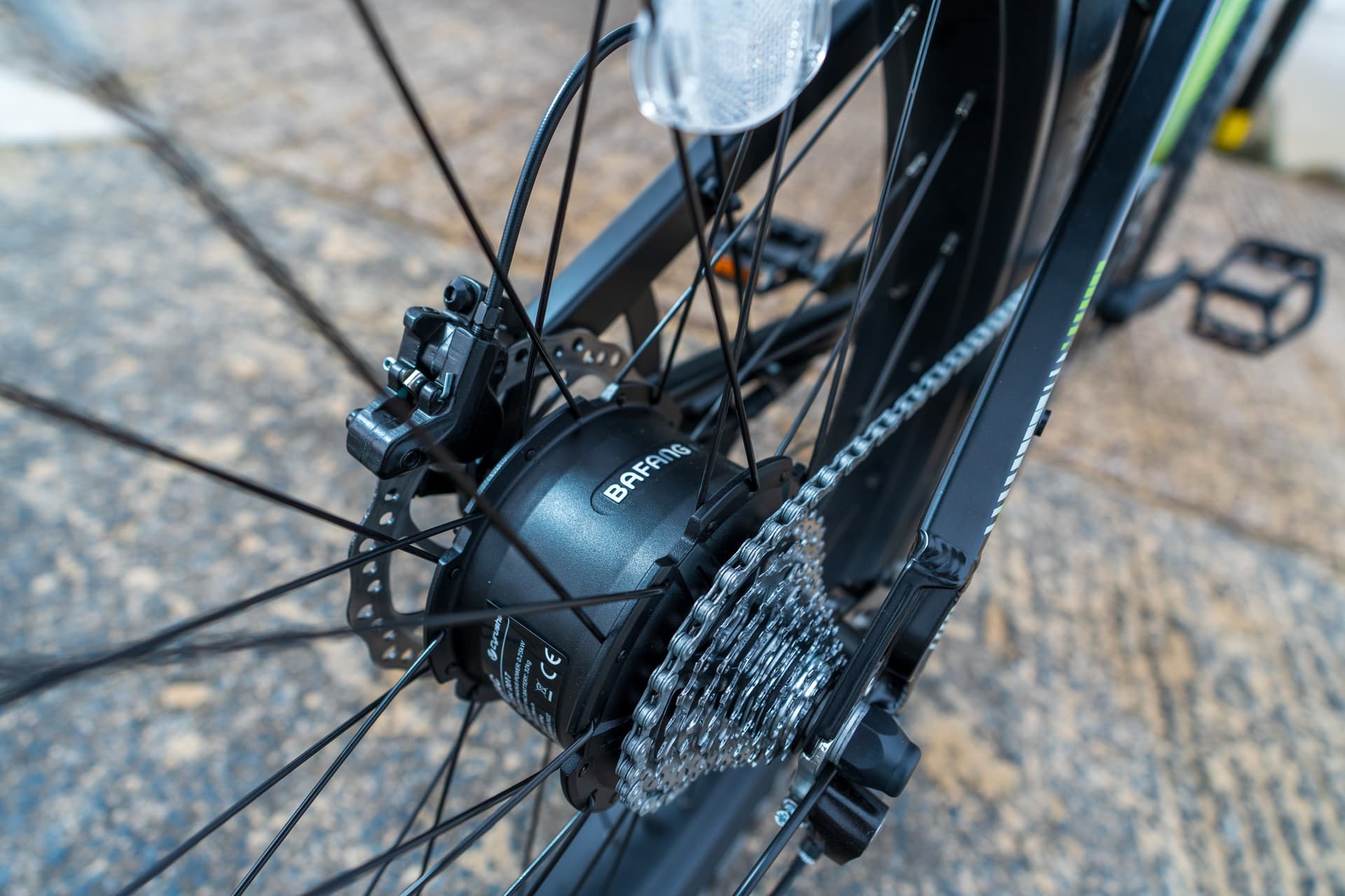

Chain lubrication is a crucial aspect of maintaining the performance and longevity of your ebike. Proper lubrication reduces friction, minimizes wear, and ensures a smoother ride.

Steps for Lubrication
  1. Clean the Chain
  2. Apply Lubricant ( Focus on the rollers and side plates)
  3. Wipe Off Excess
Frequency of Lubrication
The frequency of lubrication depends on several factors, including riding conditions and the type of lubricant used. Generally, it’s advisable to lubricate your chain every 100-150 kilometers or after riding in wet or muddy conditions. Regular checks will help you determine when your chain needs more lubricant.
