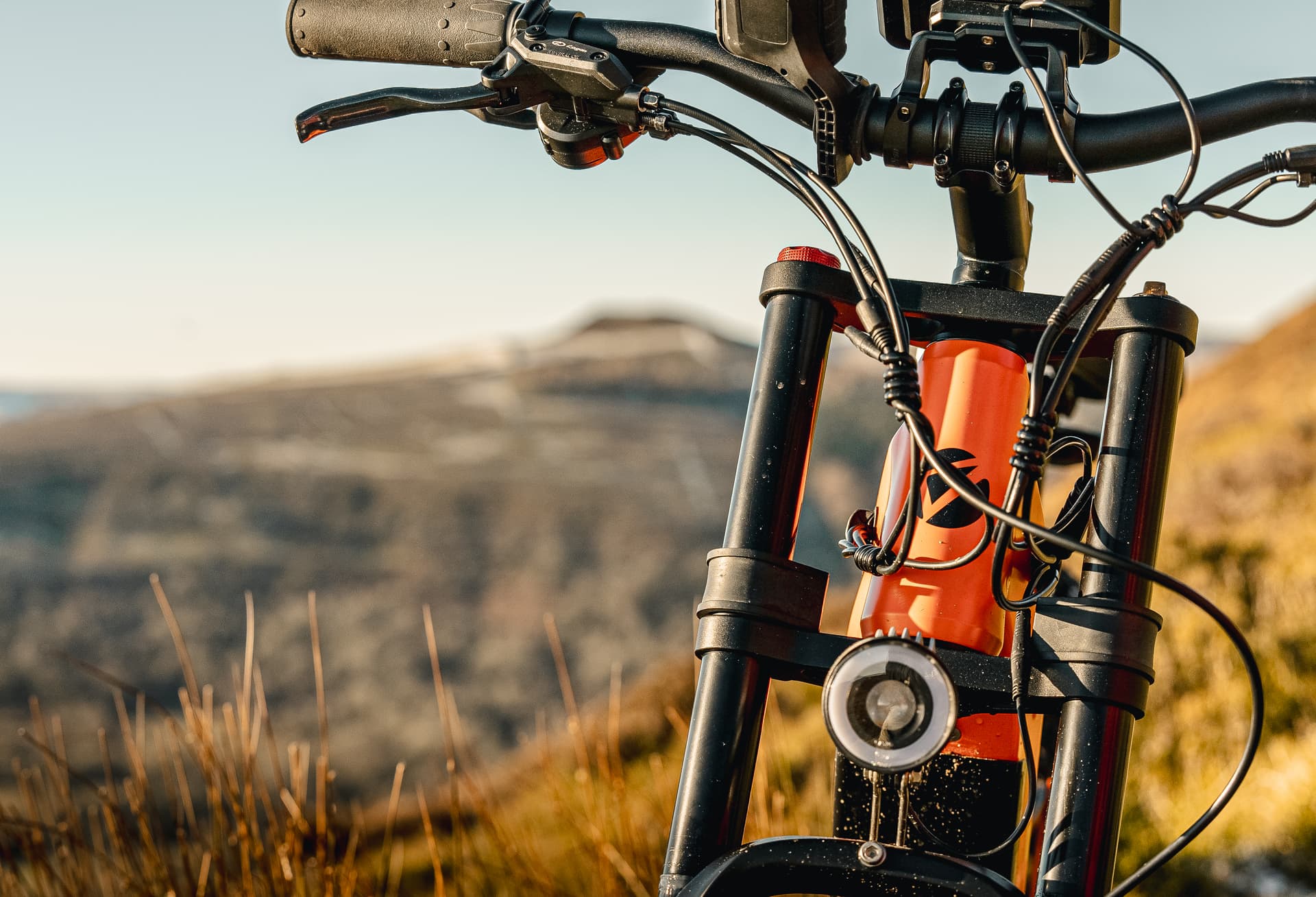

- Consider using a dual crown fork for better control and reliability, especially on long-travel e-bikes.
