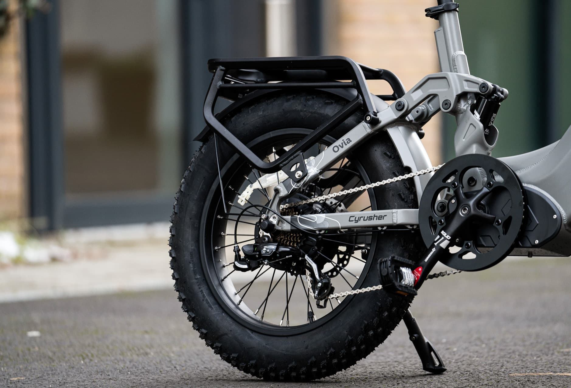

5. Clean the chain
The chain is typically the area on a bike where dirt gathers the most, but cleaning it calls for extra attention because of its intricate construction. To begin, just wipe the chain with a moist cloth while spinning the pedal to let the rag reach the chain more completely. This will get rid of the majority of the stains. A special brush for the chain can be used to deep clean it.
If you ride your bike regularly, it is recommended that you clean your chain frequently since the chain’s freshness and cleanliness will also have an impact on how smoothly you ride. To get rid of any extra dirt, don’t forget to brush major components like the cassette and chain ring as well. Lastly, remember to wipe the chain dry with a dry cloth. If possible, use a chain monitor to quickly and properly inspect the chain’s wear and tear and keep track of the condition of the chain.

8. Lubricate your chain
Use high-quality lubrication on the chain after cleaning it to keep it lubricated and prevent it drying out. There are two types of lubricant, dry lubricant and wet lubricant. Dry lubricants have a lower viscosity. They attract less dirt and dust, so are suitable for hot climates. Wet lubricants have a higher viscosity and they can stick to the chain for longer, making them ideal for use in wet and dirty conditions. To summarise, use a wet lubricant in winter and a dry lubricant in summer. Remember to apply the lubricant on the inside of the chain rather than spray it on. This way you can make sure that the lubricant directly contacts the wheels.
