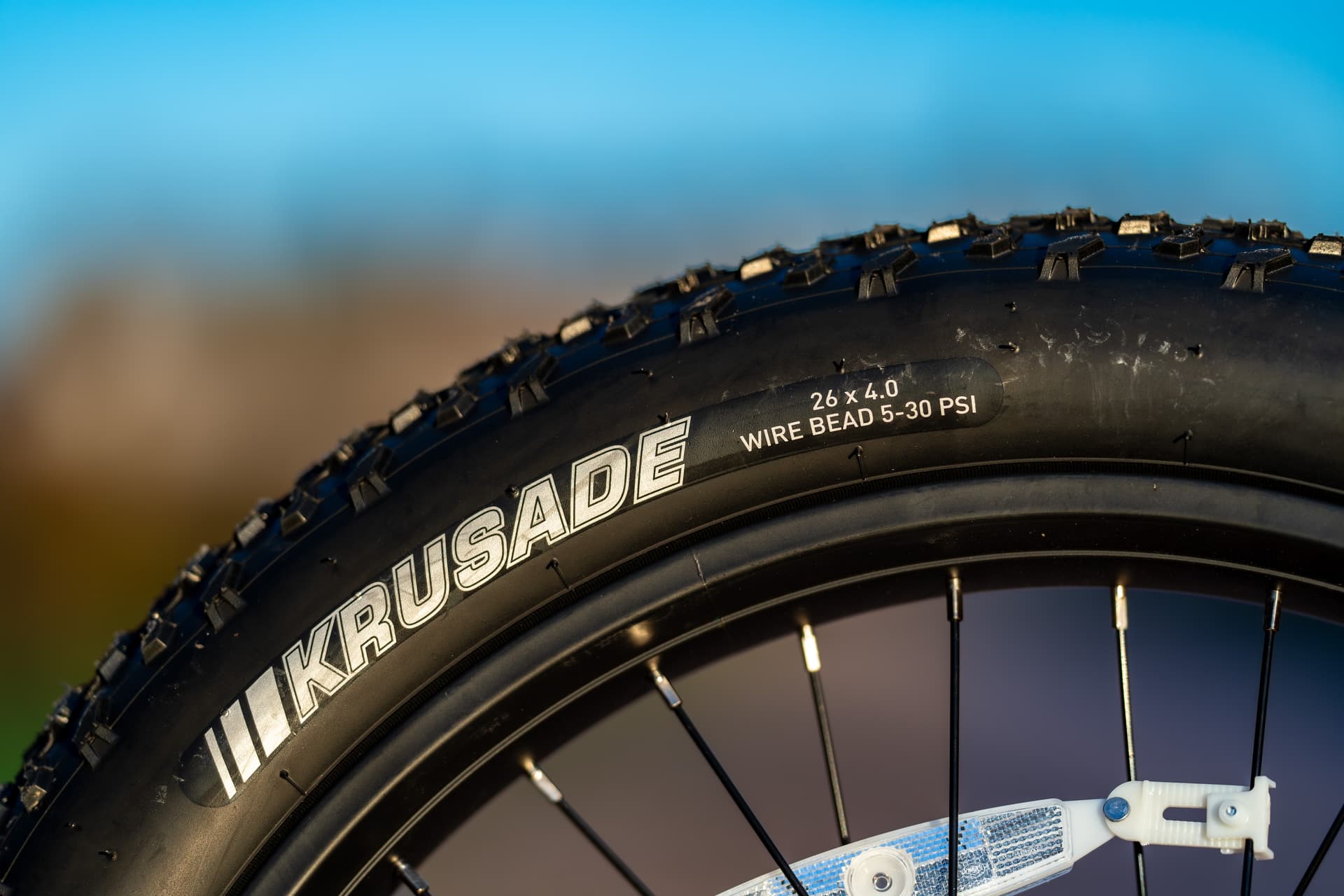

  • Check Tire Pressure
Ensure that your tires maintain the proper tire pressure for each ride, which helps assist the shock-absorbing forks in effectively absorbing vibrations and ensuring optimal cushioning of the vehicle.
