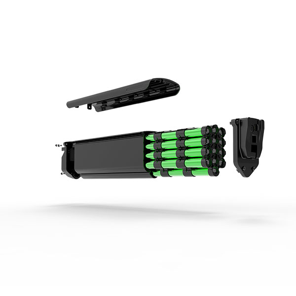

As we all know, a lithium battery can offer up to 800 recharge cycles. After a long period of use, its storage capacity will drop extremely fast which means it needs to be replaced. There are some batteries that, if not replaced, can have their internal structure damaged when a collision happens during the ride. This results in ‘thermal runaway’ when the battery heats up which leads to explosive combustion. Therefore, if the internal structure of the battery is damaged, it should be replaced as soon as possible and with the original battery manufactured by the same company.
