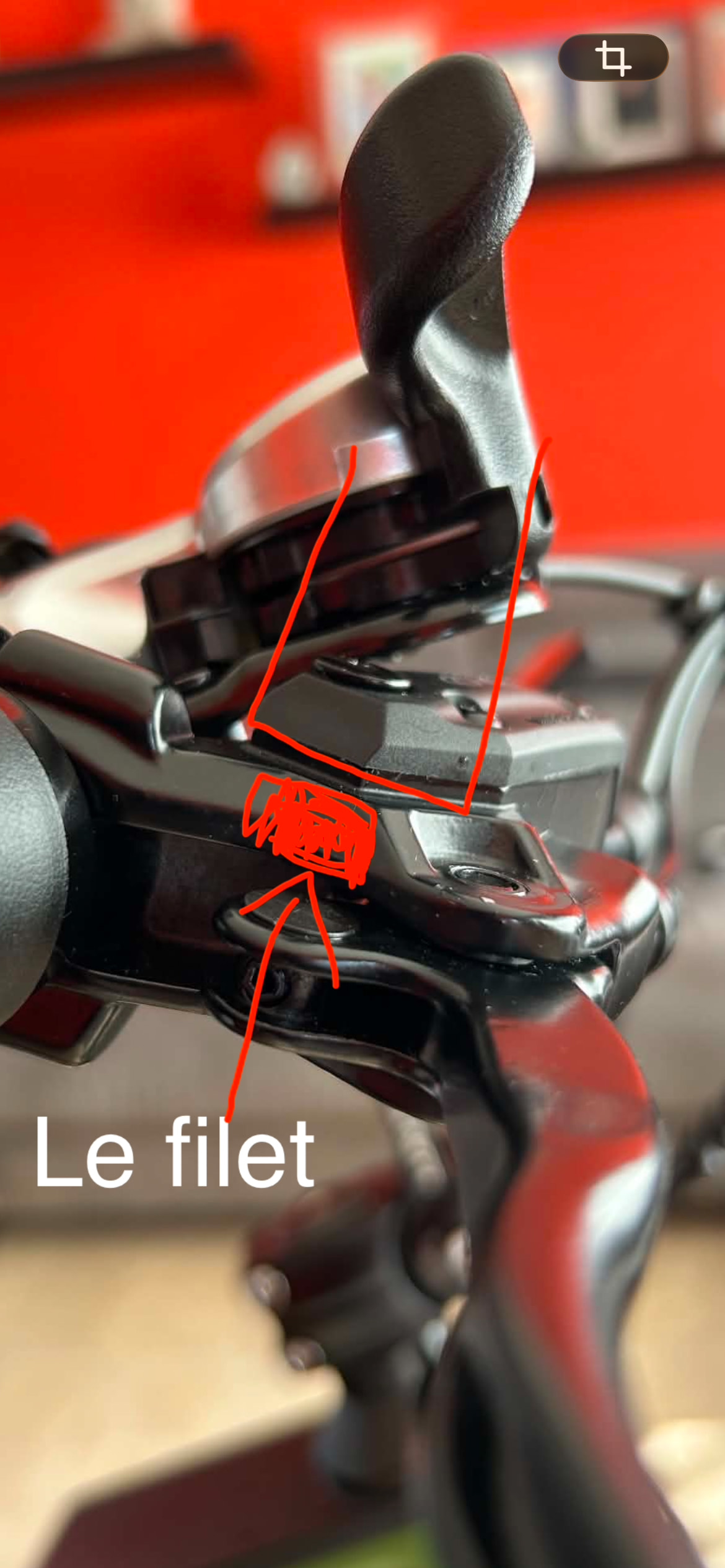

Hello everyone, I have a brake problem that I can’t solve. I had to change the front discs because they were warped. After changing and aligning the pads, the noise persists at the front: when I turn the handlebars, the disc touches the pads. And at the back, there is a noise every time I start off or pick up speed again. The brake levers are mushy. I tried to do a bleed and now I’m in a real bind; at the brake lever, no bleed adapter fits, the thread is too deep :face_with_peeking_eye:. Also, the fork rebound is completely stuck; I had to take it apart for greasing and the part is damaged (even with the right wrench, the teeth are slipping). I’m limited to one photo :see_no_evil_monkey:

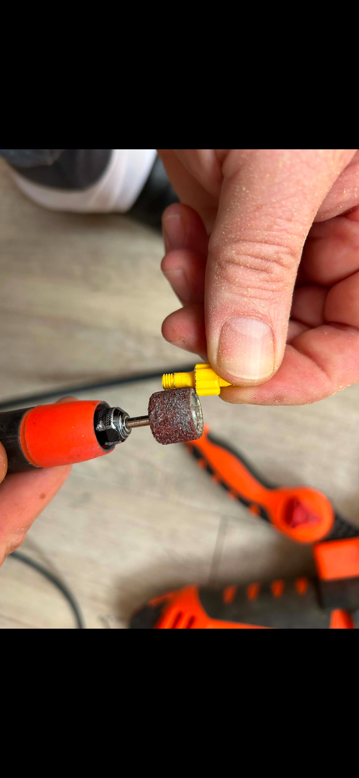

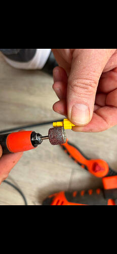

Good evening, I’ve already done all that, thank you. Just so you know, no adapter will fit into the Zenith’s bleed screw; the only option is to rework it with a Dremel. Regarding the persistent noise from behind, it’s coming from the engine. When cold, it’s fine at speed 1, but if you push it a little too hard, it makes a noise like something is rubbing inside :see_no_evil_monkey:
