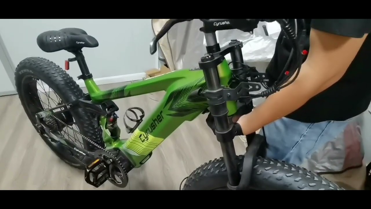

Hi there, please check this video and steps:
  • Use M5 and M4 hex keys to remove the stem cap bolts and loosen the stem clamp bolts. Lift off the stem and spacers.
  • Use an M5 hex key to loosen the 3 bolts on the upper fork clamp. Lift off the clamp.
  • Hold the fork upward. Install the lower bearing with no gap to the head tube. Slide the upper bearing cover in place.
  • Install the upper clamp, spacers, and stem while still holding the fork. Check gaps—small, even gaps are OK.
  • Tighten the top cap bolt into the star nut, then tighten the 3 bolts on the upper clamp.
  • Loosen the stem cap slightly, adjust stem position, then tighten the 3 stem clamp bolts.
Hi Julin,
Thank you for sending this video and instructions, I will try this process and let you know. I see this is done on the Ranger 2.0 but I suppose process is the same for 1st model.
Yes, it’s the same process for Ranger 1.0. Just drop a message if you have any other questions.
Problem fixed thanks guys, appreciate your help, no rattles at front now!
