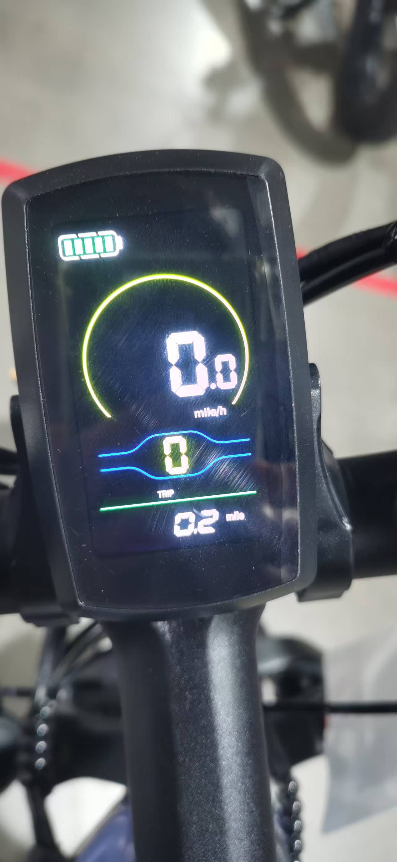

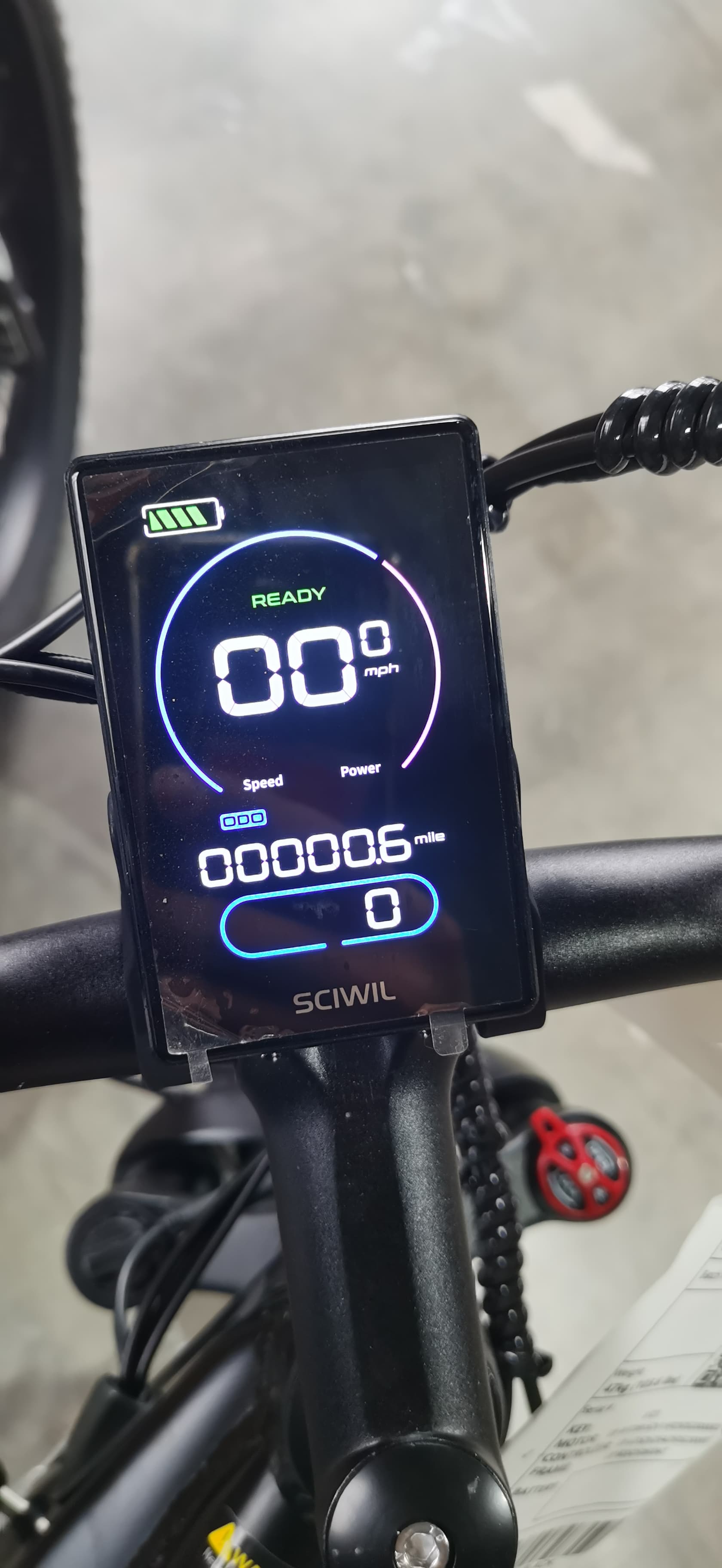

Hi there! I’ve double-checked, and it turns out the Rover display has been upgraded, so there are actually two versions out there. The old version doesn’t allow resetting the trip, but the newer one does.
Here’s a quick look at both versions:
Old version:
New version:
If you have the new version, here’s how to reset the total mileage:
Long press the “+” and “−” buttons to enter the settings menu.
Tap the power button briefly to cycle through the options.
When you see “P08”, long press the “+” button to clear the total mileage.
Once done, long press “+” and “−” buttons again to save and exit.
